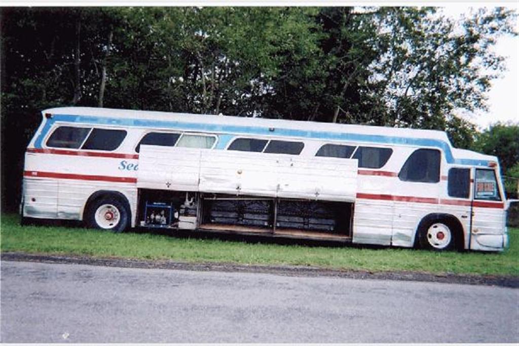

Okay, I need to know if I am right in assuming that GM once again innovated the now commonly used pantograph style luggage bay doors.
These doors are different from the old bay doors used in the older buses that swung upward and hung on a hinge at the top.
These doors instead swings upward without moving far from the body of the coach and can open without needing a lot of room.
From what I can see there are 4 arms, 2 on each end.
The 2 at the bottom look straight and the upper ones are bent.
I have not seen clear pictures of this and I have no way of finding one here close to home.
Some say that there is a rubber connection to the doors. I don't see how.

Here is an example
 Filesize:  120.78 KB
 Viewed:  55610 Time(s)

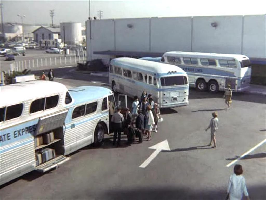

here is a scenicruiser
 Filesize:  76.97 KB
 Viewed:  55608 Time(s)

This is an old GM with the old style doors that was typical of all buses before the Buffalo bus
PostPosted: Wed Feb 10, 2016 12:33 am    Post subject: Reply with quote
GM started using rubber hinges in 1951 with the introduction of the PD-4104. They were used on the baggage doors of the 4104 and 4106. They also used rubber hinges on the fuel tank door and the battery compartment door.
The first buffalo was the PD-4107 in 1961. These were built in the same Pontiac, Michigan plant as the fishbowls, and used a lot of the same body and mechanical parts as the fishbowl.
The 4107 was the first GM coach to have telescoping baggage doors. Biggest complaint on the 4107s was they were difficult to shift. Completely different feel than everything else. You had to shift and double clutch as fast as you could move! I ground a lot of gears till I got it right.
